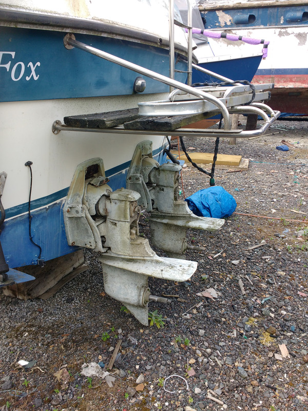

Can outdrives be trouble? Absolutely!
Do outdrives bring some benefits making it worth living with the possible downsides? Yes, of course.
Three of our six boats have been on drives and in our experience looking after them makes a difference but it doesn’t provide a guarantee. Removing the dipstick each year to check the oil was always approached with a degree of trepidation - would it be milky (meaning water ingress) or not?! ?
As QBhoy says, if you get to understand them and remove the mystery it becomes less daunting and you realise that things can be put right but having a slush fund to do so can be handy. But if you are unlucky they can be a shedload of grief!
The benefits are obvious - a bit more economical than shafts (but let’s not overplay that - it isn’t massive for the number of hours the average leisure boaters does and notably offset by higher maintenance costs) but importantly they create space so you tend to get more living area out of smaller hulls on some types of boat. A friend did the French canals in an outdrive boat and when he got a rope around the props the benefit over shafts in those circumstances became very obvious as he lifted the legs and was able (eventually) to cut the rope off. If it had been a shaft boat they would have been in real trouble.
My preference is for shafts - very little goes wrong in reality and maintenance is very low - but I wouldn’t rule out drives if it meant that we got the right kind of boat for our needs. In fact that is exactly what we did when we bought our last boat, a Sealine S34, which was a great boat. ?
