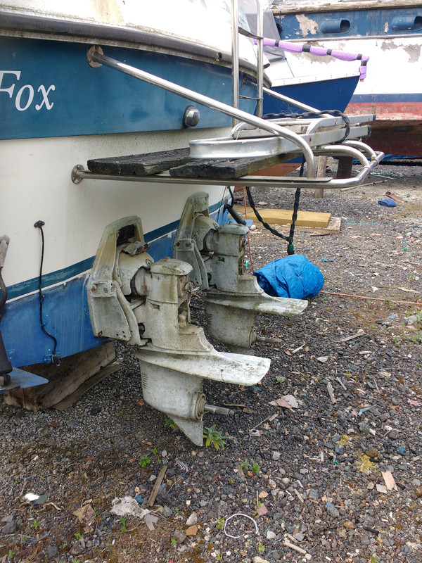

Cheap to install .
After that its get your wallet out its an expensive race downhill all the way to a cinder surface surrounded by Ragwort.
a 5 min walk for this little selection of delights. :)
