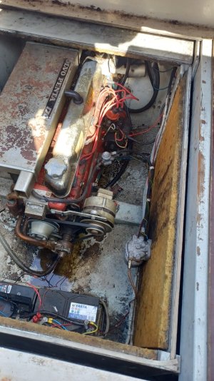

We have a workshop in the Port area that recons alternators and starter motors ...
Refueler
13 Sep 2008
20,463
Far away from hooray henrys
Starter motor removed ... while doing it - found top mounting bolt loose ... and the 'white' wire in photo above - connecting tab broken ... so now need to find out where it connects when starter comes back from service ... as you see in photo - its underneath and out of eyeline !!
