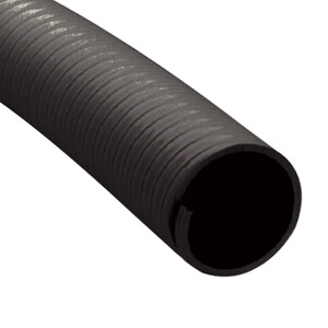

A bit of plastic pipe of a suitable diameter. For the snubber I used on Jissel, I used a foot of this
It was looking pretty tatty after 10 years' use, but still did the job of protecting the rope and my sleep
