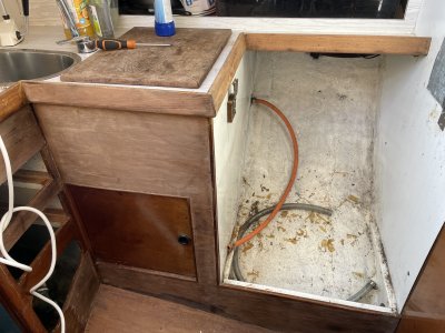

Hi,
My sailing season has come to a rather abrupt stop for the next few weeks. while its being sorted, its made a little time to get things in order within the cabin and galley. A Contessa 32 heavily varnished and it just feels too dark. Ive carefully started removing the varnish and the wood is in good order. I dont wish to paint, as I may end up regretting this. Id like a lighter feel and perhaps a Matt Finish. Any suggestions on types of suitable products and should I use a bleach to clean the wood. most of which is stain free.
I am hoping to work in sections rather than starting a full internal refit I dont have time to finish.
Any advice appreciated.
Steveeasy

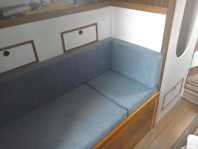

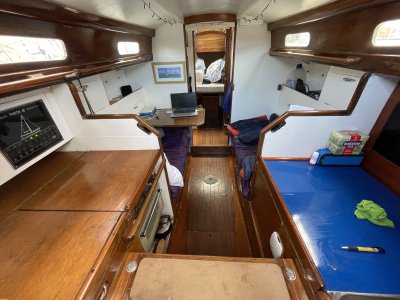

There is wide range of products specifically for interiors, lacquers, varnishes, oils and polishes that will achieve the muted finish that the OP desires - and Tonkinois does not have the properties that will achieve this as you can see from here.
Le Tonkinois
So "all you need" is simply not correct, It is one of the better finishes for external work, although in my experience there are better - but it is often a matter of personal preference (and habit!).
Lacquer is preferred by many builders for the reasons concerto mentioned. For fine finishes in custom building Epifanes is often the finish of choice but it is time consuming to get that perfect drawing room furniture finish. Personally I use Ronseal satin, as being a poor lazy painter gives a good long lasting finish for little effort. It also blends in very well with finishes used on many modern boats like the Bavarias I owned, although I am not sure I would use it on large expanses of veneered bulkheads unless I was stripping right back or using new veneers as in the pictures attached. The first 2 were taken about 20 years after the finishes were applied and the last is new (in a different boat) There are no doubt many other good products available but few of us DIYers try enough of them to be able to give a balanced view.
If the OP wants to recreate the original then suggest he contacts Jeremy Rogers' firm to find out what they use, As ever it is the preparation that is key, not the final finish and stripping completely and refinishing is a mammoth task as concerto explains. That is perhaps why so many older boats need such drastic treatment - owners investigate and decide it is beyond them! Solid trim is relatively easy but large expanses like main bulkheads are challenging.

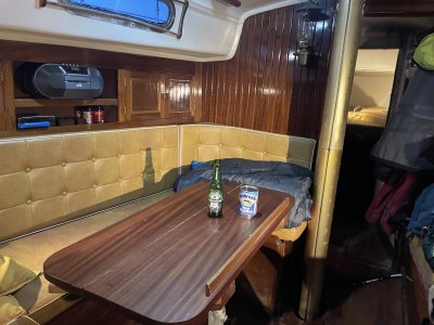

Hi Traona,
Firstly excuse my supper. A tin of rice pudding and a bottle of beer.Nice!! Well desperate as the shops were closed in Oban at midnight. Frankly I dont like the inside of my boat. too much dark wood. I can live with the bulkhead. its done well and I suspect original. Dont think I could improve it. I wish to improve some of the smaller panels and have started the galley. although it does not look particularly good its in reasonable condition. Ive seen others use white which I like but worry over it flaking or looking tatty, so I am hoping I can use a stain or Laquerre or matt varnish.
The upholstery does not help, but its well made and in good order and im trying to live with it. The Table is awful. I hate it. Not too much to like yet apart from the varnished cupboards which are in superb order. Perhaps I need an interior designer but on a B&Q budget. My former boat pic attached probably answers my question in that there was good contrast of wood and white. made for a good feel. Ill have to give it a lot of thought which may not get me anywhere. Perhaps more time in the cockpit where all is well, well should be.

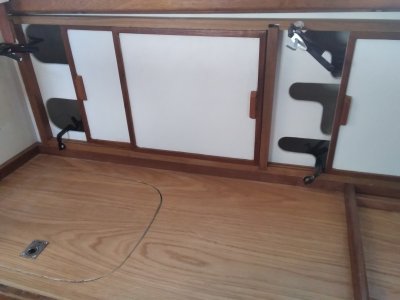

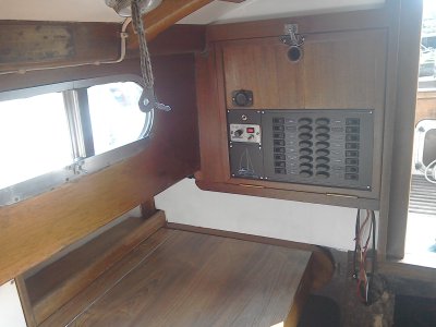

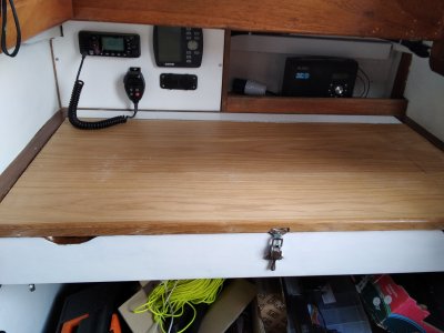

Some more photos of my current project. White is Dulux Satinwood, similar to what I used 30 odd years ago on the previous boat. Very easy to apply but not very scratch resistant, but most of the surfaces are non wearing. Light veneer is American Oak finished with Osmo oil (as used for kitchen worktops). Dark trim is either teak on the original lockers or a mixture of sapele and iroko.
Nice contrasts. Think I need to use white but in moderation leaving existing trim.
