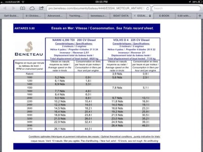

This is the official Beneteau stats. In my experience they are a little optimistic but not far out.
If your after a small flybridge that is big enough to stay away in and has decent/safe decks and engine access I don't think you can beat them.

We have a 9.80 with Nanni's.
The rpm / speed table posted above reflects our experience.
Reckon on just under 4 mpg at 1800 rpm and just over 2mpg at 2800 rpm.

Yeah looks roughly like 10kts an hr equates to 10 ltrs an hr ie 20ltrs an hr.

10knts at 10 ltrs x2 engines = 10knt miles in an hr for for 20 ltrs fuel
20knts at 25 ltrs an hr x2 engines = 20knt miles in an hr for 50 ltrs fuel
So traveling at 10knts is 25% more efficient than traveling at 20knts
Am I right there?
