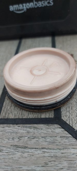

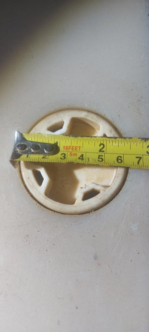

Our boat has an opaque 'plastic' fuel tank. In tha absence of a fuel gauge, monitoring of the fuel level invoves me dangling my wife upside down in the 'big locker' to determine how much/little diesel is in the tank. She has expressed a modicum of reluctance to this exercise. One of the winter jobs this year has involved clearing out some ducts around tehthe top of the tank - to reveal an 'inspection plug' on the top of the tank. It's 60mm in diameter and is relatively easily removed (whilst the infrastructure is out of the way). 'Result' thinks I - we can fit a fuel sender and gauge. Some research shows that the only threaded senders available are 1.25" thread - too small for my 60mm opening. I don't know what the thread pattern of the existing 60mm cap is, unfortuanetly.
I'd really like to use this existing aperture to fit a sender - any suggestions? 60mm - 1.25" reducer - does such a thing exist? Whast is the likely thread pattern of the existing 60mm cap?

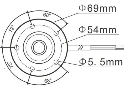

Would this be any good?
Furneaux Riddall
You could pot it into the existing bung with Sikaflex maybe with a few bolts to ensure mechanical security when you unscrew it. Don't know what length you need.
That looks like a possibility, although I don't think that I could use the bolts - they'd be right at the edge of the existing cap. Potting with sikaflex definitely worth considering. I'll try to source a spare cap first, in case it all goes awry.
You could probably drill a couple of new holes in a suitable location to suit the cap. You will need something protruding above the flange to get a purchase to unscrew the cap for maintenance which might be quite tight.

I fitted one of these to a friends boat. Luckily he also had a plastic tank. Drilled a hole close to the inspection tank hole to allow your hand to reach in with the nuts to secure the sender to the plastic. I had a plate made up as a backing to the nuts securing to the underside. Comes complete with the guage and cables. Wire up as the diagram. You just need to measure the depth of the tank to get the correct sender.
0–190 Ohm Kraftstoff-Schwimmersensor + 52 mm Kraftstoffstandsanzeige, 7-Farben-Licht, wasserdicht, IP67, Öltank-Messgerät, Anzeige, Auto, Yacht, 12 V, 24 V - AliExpress 34
Update. My local blacksmith created an adaptor for me by turning down and threading a block of nylon.
I sourced a 1.25in threaded sender and he made an adaptor into which the sender screws. The adaptor and sender then screw into the aperture in the tank.
