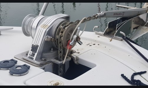

Hi, I have no experience of that winch but it looks good and the all stainless steel construction is appealing. Previously, I saw this one on a other 760 which looked like a good fit but I now like your choice!After all effort I didn't find 8mm gypsy for my windlass Leroy Somer S801 so I am looking for complete new unit. And found this product that could be best alternative. What do you think?
Lofrans Razza
If you go ahead and fit the Lofrans Razza windlass, do you have a plan for your existing Leroy Somer one? Mine needs a replacement aluminium casing due to corrosion.After all effort I didn't find 8mm gypsy for my windlass Leroy Somer S801 so I am looking for complete new unit. And found this product that could be best alternative. What do you think?
Lofrans Razza
Yes, I keep scraping of the loose paint and touching up but I would like to get a half decent casing to renovate properly and then swap. Knowing how likely threads will strip when Stainless bolts are in aluminium I don't want to risk trying to dismantle mine without a fallback.I have noticed my LR windlass has flaking paint. Is yours more than that Plum?

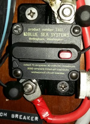

My main problem is that it doesn’t work though!! I suspect the LT wiring or solenoid. I’ve found the 40 amp fuse on the engine bay forward bulkhead. Thats ok. Any ideas where and what the solenoid is, or looks like?
On mine, the winch is fed from a 75a circuit breakerI have noticed my LR windlass has flaking paint. Is yours more than that Plum?
I'll keep in mind.. For know, I am only thinking about..If you go ahead and fit the Lofrans Razza windlass, do you have a plan for your existing Leroy Somer one? Mine needs a replacement aluminium casing due to corrosion.
Thanks. There is no click felt pressing it with or without the engine running, so I’ve spoken to an electrical engineer member at my club today, he says 90% plus of winch issues relate to the solenoid or a bad earth. So I’ve asked him to look at it for me.That black unit with the red button in my picture is the winch circuit breaker
I looked closely at mine today. My guess is that casing was powder coated originally. It might be worth looking around to have it stripped and re-done?If you go ahead and fit the Lofrans Razza windlass, do you have a plan for your existing Leroy Somer one? Mine needs a replacement aluminium casing due to corrosion.
