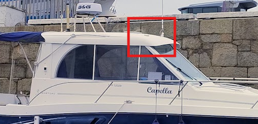

I recently bought a Lowrance Point 1 electronic compass/GPS puck for radar overlay on my plotter and I wondered if there was a preferred good location to fit it.
Instructions say keep it away from magnetic sources, vhf, electric motors and engines etc.. Quite hard on a 26ft boat :)
I was planning to remove an old redundant Raymarine GPS sensor that is still on the roof and replace with the Point 1.
That seems to be a reasonable spot out the way and hopefully avoid drilling unnecessary new holes.
Anyone else successfully fitted one or similar?

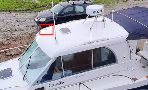

Assuming nothing under the roof, that should be fine.

Not fitted one but hopefully your magnetic compass below it is far enough away. On most of the 760s I have seen there is a radio speaker in the roof panel inside immediately below that position?
Ah yes that's a good point, I have a pair of small speakers inside below on the headliner... I'll try it out and see if the heading sensor works ok. If not, i can remove or relocate the speakers, don't really use the original stereo much tbh as they're really weak.
I did say "Assuming nothing under the roof" ;)

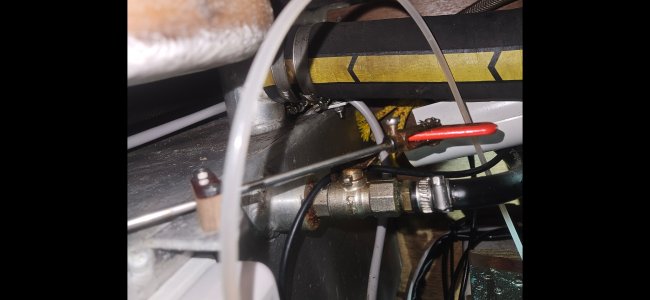

Does anyone on here have a diagram of the fuel tank on the 760 or photos of the tank removed? I need to know where the pick up and return ports are and my boat is currently in a dry stack.

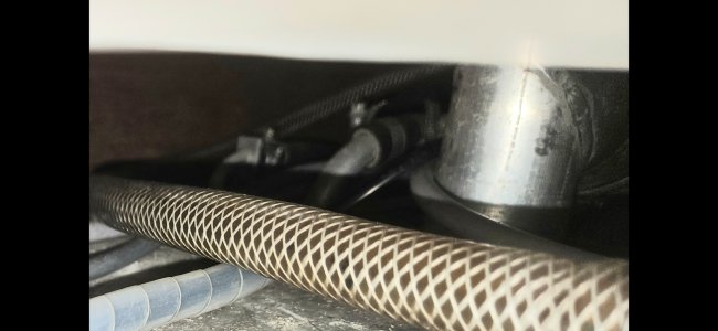

Haven't got good pictures but they are both on the starboard end at the top. In this pic, looking forward, you can see the pickup port top corner nearest the camera with the fuel shut off valve.
The return goes in on the top surface in the corner. In pic above it is beyond the filler hose. In the pic below you can just see it in the centre with the filler to the right of it.
With the pick up coming ut of the side does anyone know what the actual pickup tube inside the tank looks like? Is it a metal tube or plastic? I'm getting air in my fuel and a split pick up is one of the item I want to check.
