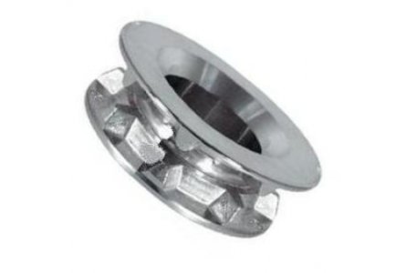

This is barbotin. There is not 8mm for Leroy Somer as I think..

Amazing. Are you sure you have 8mm? Have never seen the info that exists for Leroy Somer. Do you have an info where could I buy it?

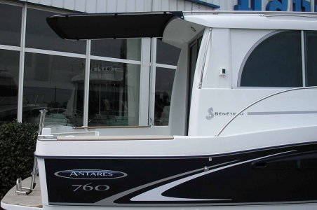

Btw, any suggestion which top to install on the stern? I prefer hard top over bimini, but I'm not sure how much it impacts driving at higher speeds.
Plum, thank you on your answer! Hopefully this will be a result of my inexperience and not knowing the boat so good.
Depends on whether you want a fully enclosed cockpit or just a sun awning. I only have a fabric sun awning for use when not under way. One that I have seen and admired, better than mine, is this one. No supports and the frame, when the fabric is removed, can be slid forward:-
I would like to have a fully enclosed cockpit so I plan to have the fixed one. But I don't know what are the downsides of the fixed one when driving a boat.
Mine is the original Leroy Somer winch and I have 8mm chain. I believe they fitted 10mm barbotin to some of the Beneteau sailing boats. Your barbotin is what i call a Gypsy 🙂
Plum, now I am a bit confused, because on one French forum I read that gypsy is 8/10 mm? Do you think is possible that one can take both 8 and 10 mm ?
In just my experience, no. Also, there are two sizes of 10mm chain and each needs a different gypsy. 10mm chain can be - DIN766 (10mm x 28mm links) and ISO4565 (10 x 30). I can't guarantee I am right though 😀 so hopefully others will reply too.

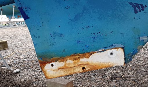

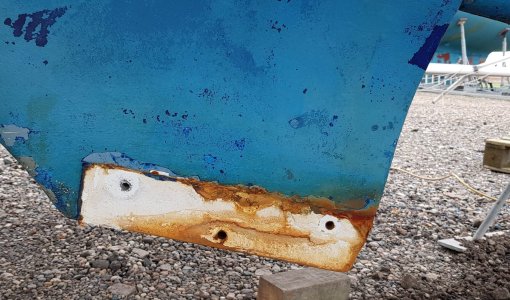

Recently bought 2005 antares 760.
the bar connecting the back of the keel to the bottom of the rudder is badly corroded.
very expensive to buy replacement.
has anyone got any thoughts ?

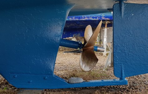

How bad is it? What is the reduction in thickness? Assuming it is galvanised steel and only minimal reduction in thickness then remove, grit-blast and re galvanise. It should also have a zink anode too. If the corrosion has significantly reduced the material thickness then a local engineering/fabrication company will make you a copy from your old one and get it hot dip galvanised.
and below, this is what the skeg looks like when the metalwork is removed (different boat)

I changed mine two years ago and have the old one as a spare. It’s in a pretty good condition. If you want you can PM me.
Very interesting comments about the keel / skeg... I was literally thinking about looking into a replacement this week!
Mine has suffered a bit with corrosion and wasting in the marina (i do check and replace the anodes but the boat is 20yrs old).
Before it gets too bad I would like to replace.
