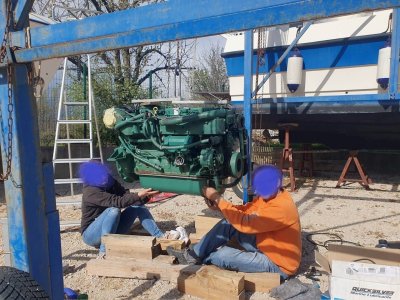

Did you manage to find new engine mounts with the same hole spacing?
Good morning Tomaz, Thank you for feedback. My oil pan is very rusted because of a leaking oil cooler, sea water pump and there is no bilge pump in the engine bay. This boat was very neglected. I bought it in October from Sicily. The engine runs well having only 850 hrs. So you suggest I even disconnect the reverse gear (gearbox) before getting the engine out? Yes, would appreciate the link for the engine mounts. They are still good but rusted.Yes, after long research I found them in France. Quite affordable - less than 100 bucks/piece. I can attach link if you want…
If you have 200hp engine, removal of gearbox is a must.. My oil pan looked very bad but at the end I think that it was far from starting to leak. So I have done grinding and painting of it and now I have it as a spare if someone need it. Later I discovered rain ingress as reason for rusted oil pan. About mounts, the new one will result as less vibrations.Good morning Tomaz, Thank you for feedback. My oil pan is very rusted because of a leaking oil cooler, sea water pump and there is no bilge pump in the engine bay. This boat was very neglected. I bought it in October from Sicily. The engine runs well having only 850 hrs. So you suggest I even disconnect the reverse gear (gearbox) before getting the engine out? Yes, would appreciate the link for the engine mounts. They are still good but rusted.

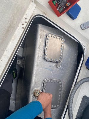

Well done on fitting the access hatches. How did you get to the bolts on the forward side of the tank, the ones that fix the tank to the hull?Hi,
Finished with the access holes. There is the third one as well, but not seen on the photo.

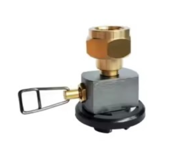

This is adapter..I also use the only one that fits, but I am also considering to fit adapter for MSF1a 247g cans. 24 cans are cheaper than 1 refill of the bottle. And I can get them everywhere while for 904 I must visit Italy.
Interesting. Thanks. So do you screw the regulator from the Camping Gaz bottle into the top? What sort of can goes into the bottom, this type? Do these all have the same connection? Amazon.co.ukThis is adapter..
Camping Gas Adapter Anschraubkanister EN417 auf Campingaz R907 R904 R901 Gasherd Konverter - AliExpress 18Interesting. Thanks. So do you screw the regulator from the Camping Gaz bottle into the top? What sort of can goes into the bottom, this type? Do these all have the same connection? Amazon.co.uk
Would you post a link to that adapter, please. Can't find it.![]()
Thank you. Excellent info. I can buy 8 of those cartridges which contain the same weight of butane as a Camping Gaz 904 exchange bottle for half the price.Camping Gas Adapter Anschraubkanister EN417 auf Campingaz R907 R904 R901 Gasherd Konverter - AliExpress 18
Hope the link works.. It's for MSF-1a 227gr cartridges. And Campingaz regulator on the top. They are cheap.

Not an expert, but usually diesel tank inspection hatches have a lot of bolts. I guess it is to prevent any leaks and to preserve a structure.Also why did you need so many bolts on the fuel tank hatches? Looks safe but just curious.
And if you remove the black piece and valve from adapter, I think you can use also EN417 cans...Thank you. Excellent info. I can buy 8 of those cartridges which contain the same weight of butane as a Camping Gaz 904 exchange bottle for half the price.
