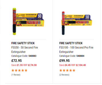

How much do they cost and where can you purchase them from ?
Force 4, among others.
No, they aren't cheap, but with a theoretically indefinite shelf life (their FAQs suggest 15 years), I must say I'm tempted. However, I've got a few powder extinguishers, and the last one of those that I dumped, I let it off into the dustbin and it worked fine, in spite of being nearly 30 years old, so I think I'm OK for now.
