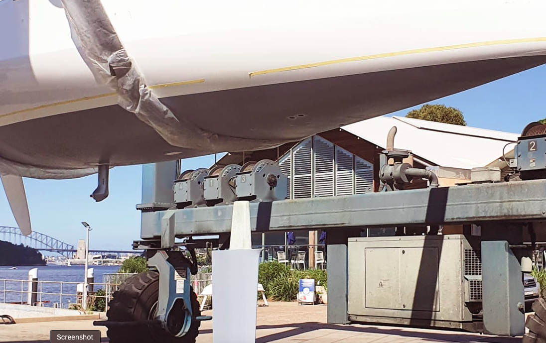

It was a "cassette" design with a section of the keel going up into a socket on the hull, then attaching at the top of the socket.
If you look at the photos, I'm pretty sure that the 2 holes on the aft end of the longitunal beam are the keel bolt holes. The fact that there are no bolts there, and no obvious signs of damage could mean that they fell out.. It could also mean that they were removed during salvage in order that they could retrieve what was left of the keel for analysis. Presumably we will find out in good time.
You can see them in happier times in this photo.
1657084738004-png.527120
IF the two bolts shown in flaming’s photo #69 are the keel bolts supporting 895kg of ballast and subject to some pretty hefty latitudinal stresses then I for one wouldn’t even think about sail an X2 in anything other than a mill pond.
But there again I’m an old fogey still has a respect for traditional long keelers, even though I now sail a bilge keeler.
They wouldn't take the latitudinal stresses. The top of the keel is in the socket, which would take the lateral forces, or at least the majority of them... See picture, the top part goes up into the hull.
clamping-png.526825
Note that the metal keel fin is the same size as the head, the rest is a fairing around it for better hydrodynamics.
I can see how the stresses would not be directly upon the bolts, but the whole arrangement seems to me to be what my engineering pals would describe as ‘insanitary’, but I am only expressing an opinion, it will be interesting to see what comes out of the enquiry.
