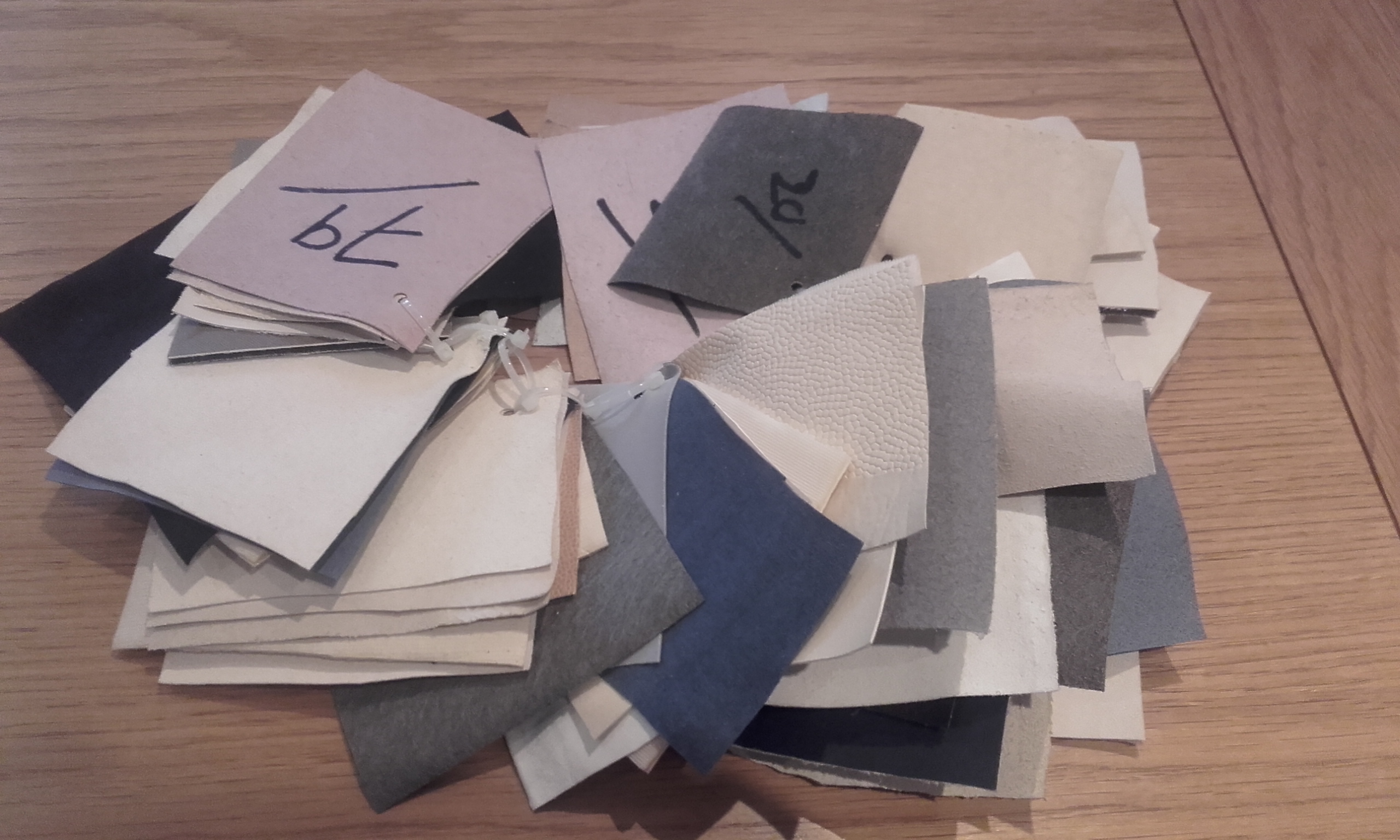

The nice people at Fairline sent me samples of ALL the legacy fabrics that they have in their warehouse.
Hopefully this will assist other owners trying to match the fabrics on their boats.
Just hope I can get a match!

But that is pointless if you can't match the vinyl, so the vinyl is your #1 task. Someone at Fairline or ex-Fairline must know, but I would expect it is no longer made anyway, so perhaps the job is to find a very close match. There are zillions of vinyls available today and surely one must match. I'll try to lake a look at JtB's targa 40 (I presume same) and perhaps then send you some samples of stocks that I have
Well, I've some success to report. Firstly, Fairline have a fabric ("Allegro White") which is close enough to the original to be an acceptable solution. So my partner and I spent a few hours at the weekend trying to remove the panel. We were able to remove the wooden trim around the edges and also the filler at the end of the cabinets. By flexing the panel we can see where it's still attached. We could also get an arm far enough up the back to unbolt and remove the the old digibox.
