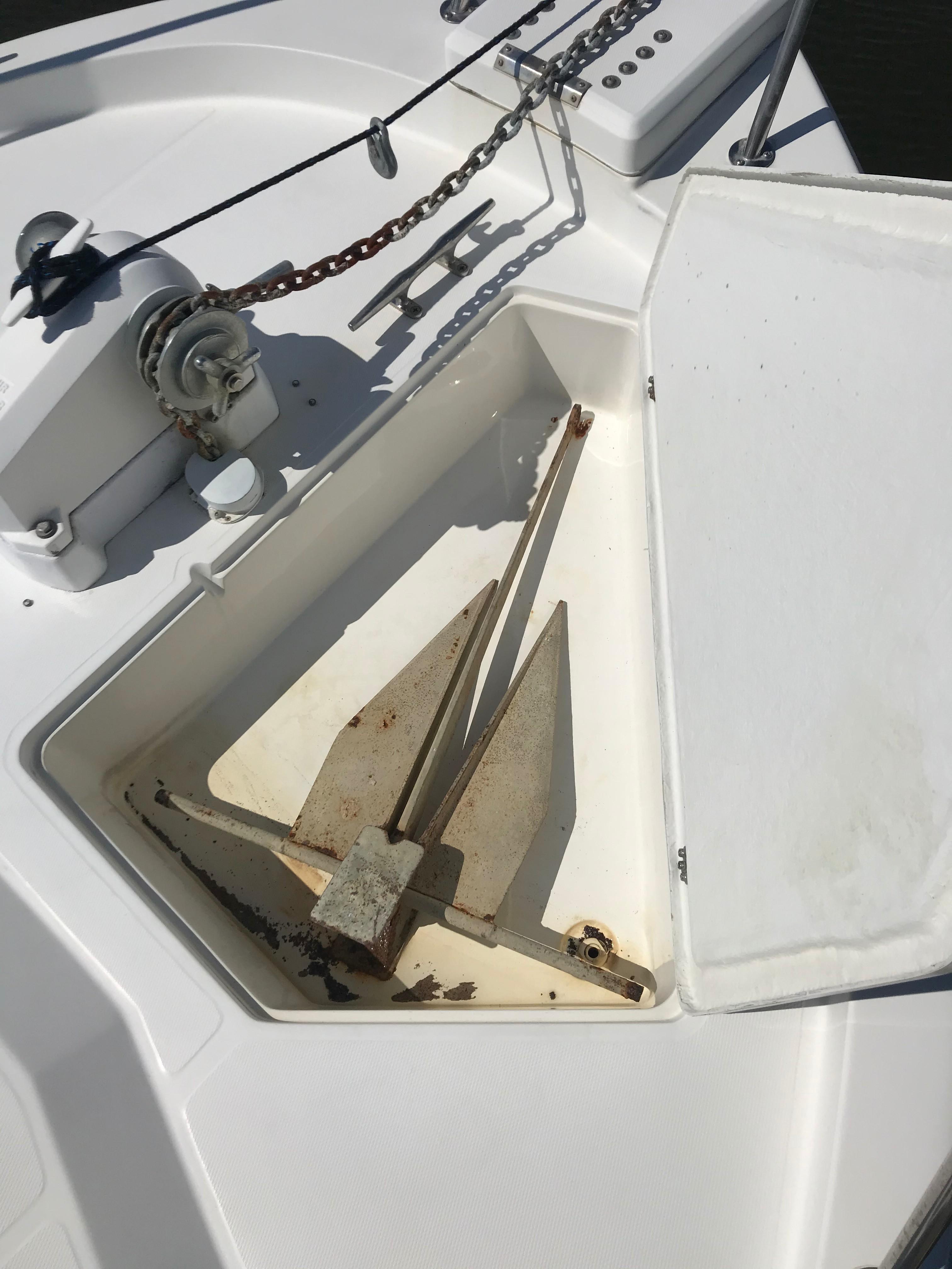

I'd have thought whether you call your locker in the bow a chain or an anchor locker most people would know exactly what you are talking about.
I see no reason for not calling it an anchor(ing) locker and I have seen some lockers in which the chain is stored with a special moulding to accept a Danforth anchor. The Danforth was stored in a moulding on the hull side with plenty of room for chain. The specific locker in the image also holds the windlass - so what are you going to call it? Thinwater has an image on the same sort of thing - seems all very sensible to me. Commonly the anchor and or chain locker is an after thought - the tiny space left over once the accomodation is squeezed in. Many yacht designers obviously don't anchor and spend all their time in a marina. Its a pity more anchor lockers are not properly designed.
Many yachts that are used as cruising yachts will take part in races and the anchor will need to be removedfrom the bow roller and it will commonly be stored on top of the chain.
