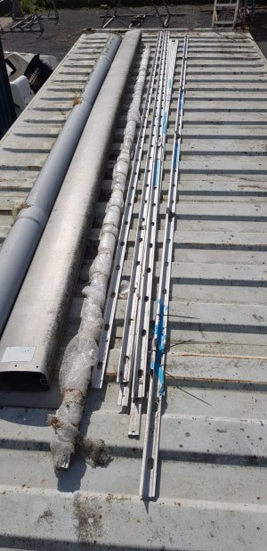

Aluminium Toerail. What is the best hand tool to use as i have no access to a mitre or band saw, would an angle grinder or hacksaw cut it?
attached is a pic of the rail of which i have a 6m lenth of at home i want to cut a 1 metre length from.
thanks all.

A hacksaw with a decent 24 tooth blade and if you are concerned about the cut a cheap and simple mitre block is your friend and guide. If you go the angle grinder route get the correct disc for aluminium.
This. You'll get a more accurate cut than with an angle grinder. If you do use the grinder, cut a couple of mm on the waste side and sneak up on the line, rather than trying to do an accurate cut.
