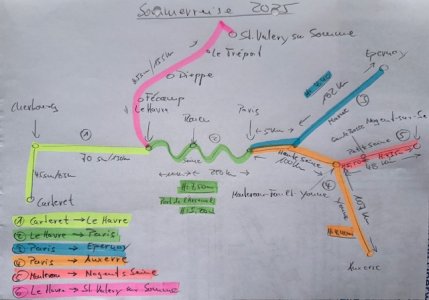

Greetings All!
First of all, please excuse my bad „school english“!
I hope you can understand my questions.
We, Stefan + Regine, are a German couple with a Beneteau Antares 9,80 lying in Barneville-Carteret during winter.
Since 2019 we cruised several times Brittany, the French Atlantic Coast, Northspain until Santander and South England from Portsmouth to the Isles of Scilly.
This year our plan is to visit Paris and North- and Southnormandie.
Our time slot ist from 24.04. to 09.10, therefore afterwards perhaps we will again make a hop to Southengland.
Some days in London is another wish on our list, but at the moment we are afraid to get in contact with a refugee boat when crossing the channel.
But this is another item.
Now I want kindly ask for some advice for two items.
1. How can I calculate slack water in the Alerney Race. The Navionics-App shows some active current arrows and a time and heightstabel.
Is this reliable?
The Reeds offers some current charts, but no real time HW Dover +/- ? for slack water in the Alderney Race.
Also I‘m not really sure about the infos in the Channel Pilot.
Is there perhaps a thumb rule for this?
I presume it‘s not really important to hit slack water exactly to the minute. It‘s more a question of interest.
We plan start in St. Peter Port and head to Cherbourg.
2. Seine from Le Havre to Rouen, maximum speed?
The other item is how fast we can go up the Seine to Rouen, without trouble about the maximum speed.
Our Antares normally feels good between 16-20 kn, but in the documents to find in the www. they write 12-18 km/h, in another place there is mentioned a special regulation for the time between 15. Mai to 15 Juni, due too protect the fish fry.
Does perhapbs anyone of you have some special information about this two points?
I would also be grateful for any other tips on our planned trip!
Many thanks in advance and a nice day in office, at home or aboard!
Cordially Stefan
