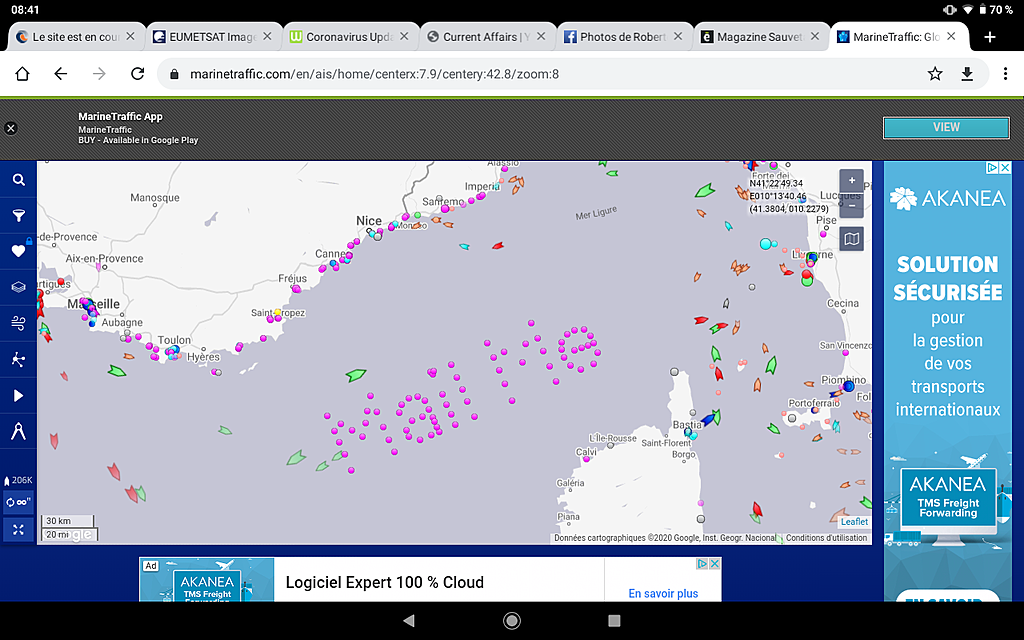

Now on MarineTraffic
It seems to have now disappeared. All the positions were sent via regular radio AIS (the receiving marinetraffic station was number 361, nemad and possibly located in Bastia).
The transmitting station was/is in Calvi, MMSI from Cayman Island, he obviously never moved and managed to send fake positions from where he was, pretty much like ais virtual AtoN.
Someone with an ais receiver at sea would have seen the same result.
How can you know it wasn't a local kid with a transmitter using a random mmsi picked from the web? Or that someone hadn't hacked into 361's account and added the messages that way? Prob not very hard once you have the password. No other station picking up the radio transmitted messages? What was the mmsi?

I don't know what we see here is bad input or if someone have hacked MarineTraffic: Global Ship Tracking Intelligence | AIS Marine Traffic
In the app it's also possible to send position data not originating from AIS
Could this only be seen if receivers were local and in range to the original transmission if via radio, also they would have needed to be on a world map to see the reported location if as you say the original appeared to be from the Cayman Island
Good, so we all seem to agree that with a bit of fiddling anyone can broadcast *any* AIS position and navigation data through radio, not only Authorities entitled to broadcast AtoN data.
I often read here "you cannot have false vessel position as the GPS is mandatorily connected only to the ship AIS transmitter", just saying it is not the case (as sometimes fishing vessels have also shown, sending positions miles away from their real ones).
Then if it is a kid or a seaman bothered during Covid isolation I do not know.
FWIW, these were printscreened this morning, the MMSI has possibly been deleted by MarineTraffic on their site, neither the MMSI nor the ship Callsign ZCOH3 exist in the ITU Station data base.
The last image indicates the coastal radio receiving station having sent the data to MarineTraffic, #361.
