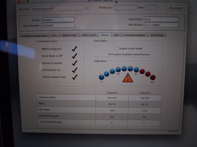

I know my Vesper marine AIS is a different model so this may not be appropriatebut is there no built in AIS configuration programme which you can use to view the AIS status?
I used this on mine when I was troubleshooting my installation - (it turned out to be a problem with VHF antennae) and that is what I would suspect in your case or perhaps GPS antenna? I fitted a vesper external GPS antenna to my set up to ensure a good signal
screen shot of the display screen attached
There is nothing built into he OPs AIS to view GPS status etc, the vmAIS i linked to does that and it's also the correct software for your AIS. It will show GPS status, VSWR etc and allow configuration of the AIS.
