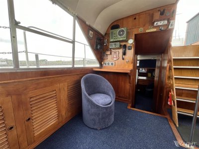

My boat had a Dutch compliant Simrad RS20 fitted, but as I already had a Standard Horizon GX2400 which is Belgian compliant then I fitted that instead, going to put the RS20 up for sale.
Down below are Sailor radios of a certain vintage, don't think that VHF complies with the new regs ;)
Nice to see an old Sailor radio.
Just removed the slightly smaller Yachting version of that larger Ships VHF radio .... still in perfect working order .....
