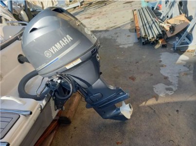

What I'm wondering about is outboard size. It comes with a 40hp outboard from its days on an Italian lake which might be underpowered for the sea? Most of the rental boats of same size have 100hp outboards, should I upgrade to one here?
I like the idea of being able to go reasonably quickly if in calm seas or of pulling a kneeboard or similar minor watersports out the back. What kind of size engine would I need for this? I'm guessing 40hp would not be sufficient?
Thanks again for all the help!
That ranieri looks nice, but 40hp is not going to be enough for going fast, it would be fine for plodding about at displacement speed though, and maybe it might just get the boat on the plane with one person and good conditions.
A quick Google suggests that boat would normally have 115hp-150hp, which sounds about right to me.
Thanks again for the advice!
So what would your suggestion be for the ideal hp on this boat: https://www.boat24.com/en/powerboats/ranieri-boat/ranieri-boat-soverato-545-grey/detail/616182/
Manufacturer suggests 30hp min and 130hp max so the 40 on it is clearly on the lowest end.
Would 100hp likely be sufficient for going reasonably fast in calm waters/theoretically dragging people out the back?
I see your comments on not skimping on horsepower but I probably don't need to be overpowered either. I don't think I've ever got anywhere near full throttle on the 100-110hp rental boats I've had.

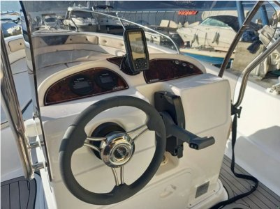

Also one other thing I see on the boat is that is has a Yamaha outboard and Yamaha digital displays. Does this mean I should swap to another Yamaha outboard so these instruments still work?
This looks to be the 100hp version of same motor from the same seller: 100cv | Motore Fuoribordo | Motore Marino | Motore Per Barca | Yamaha Motor
Will see if they'd swap out for me. My french is so poor I'd probably prefer to just get the more powerful motor from new as opposed to having to swap the lower powered one later.

I'd say that 100hp would be fine. You might be able to get some performance specs from the boat manufacturer
Also, would stick with Yam to save swapping out the gauges etc.

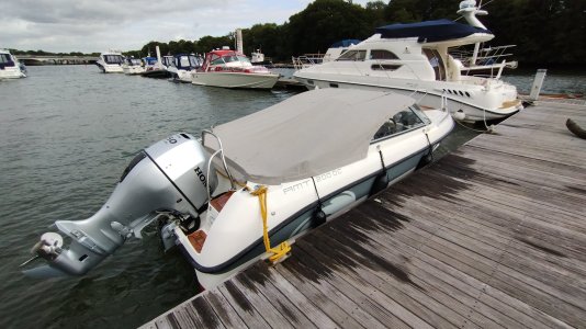

The dimensions are a bit tight - I wondered if a boat like mine might suit but according to the manufacturers spec the beam is 2.20m, but the length is good @ 5.20m.
Westport Pilot 6
Good little sea boat, ideal for fishing, not sure about water sports but re pax - I think you'll strugle to find something @ 5.5m that can (safely) take 6-8px

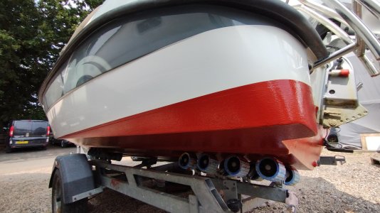

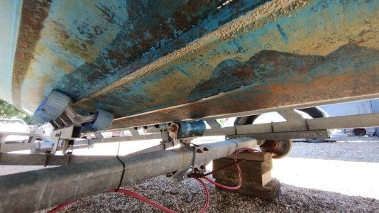

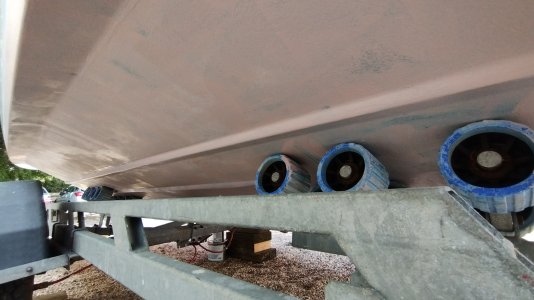

If that was my boat I'd be applying Silic One which isn't an antifoul but a fouling release paint.
Your hull looks very clean and after a few years of antifoul coatings it will start to roughen
I've applied this to 3 planing boats so far and as yours will top 30+ knots it will self clean.
You'll also go faster!!!
