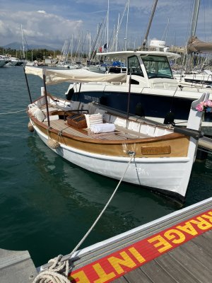

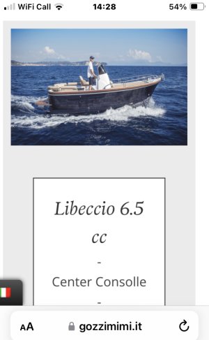

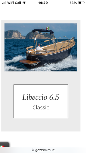

Here are some typical examples .
Mimi do a range plenty of used available.
305DAF48-58A7-42B6-BC26-AEE8CBCD4247.pngEE644908-A255-4E30-BFFE-238CFA64BEDB.jpegC19A36ED-A684-4F24-99C1-7E04D3E114B6.jpeg
A pop trad diesel inboard pechers ^

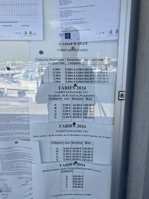

Salis tariffs ^

Salis tariffs ^

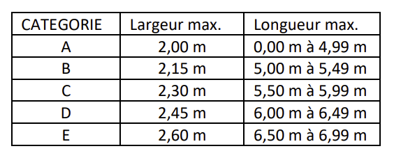

One of the issues I've just realised is that I'm quite limited with the dimensions of the boats in the category I've picked (and now can't change without going to the back of the queue which is several years!). Apparently they measure the boat to the cm and won't make any exceptions.
So my max dimensions are 5.5m x 2.15m, and I think the later is going to be an issue as most 5-5.5m long boats are >2.15 m wide. Certainly the ones you'd suggested are all too wide. That was one of the pluses of the Whaly 500, it fits the dimensions and is meant to have a good bit of internal space for the boat size.

What is the 2,15m constraint?
My mooring had posts so a clear physical constraint, (I could just squeak in) but more typical med moorings are more flexible by definition. Is it something you can chat to the marina about.
Does the dimension include fenders?

They just seem to be really fussy about it. They say that even if your boat's dimensions are listed by the manufacturer as x they will measure it when the boat arrives and if it's 1cm over they won't allow it.
Seems a bit harsh, I'm guessing it's to stop people bringing in bigger boats than advertised as the port is tiny. I've gone back to them to see if they will allow me a slightly wider boat, I'm happy to pay more for it but they seem to be tricky enough. I've been waiting a few years for any space to come up and said I'd get a boat to fit with whatever dimensions they wanted. Here are the categories, all look quite narrow for their lengths:
My marina is also very rigid on not exceeding the width limits by even a small amount, they're OK being flexible on length, but not width
