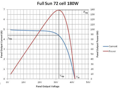

Either of the first two on your list will be fine - the voltages are near enough and its all theoretical anyway - 4 identical panels in a row can have varying light, shadow and so forth and put out several volts difference and work find in to the MPPT charger you have and work ok. Its not the most efficient way but the world will not end and the batteries will get more charge :)
Do bear in mind that energy lost is produced by the larger panels and dispersed in the smaller ones, heating them up ... so don't make the difference too big.
I believe that most panels have a blocking diode to prevent any reverse current from the battery at night and will also stop the larger panel sending power to the smaller one.
