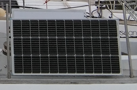

We ended up with solar panels, because they where cheaper than replacement side screens. We also didn't want side screens to the top guard rail
Mounted as we have with middle guard rail through a cable gland to protect the guard rail. We have found we can tilt them if required, as they are tied down at the bottom by light line. Which can also hold them up.
Simple cheap, effective dual purpose.
