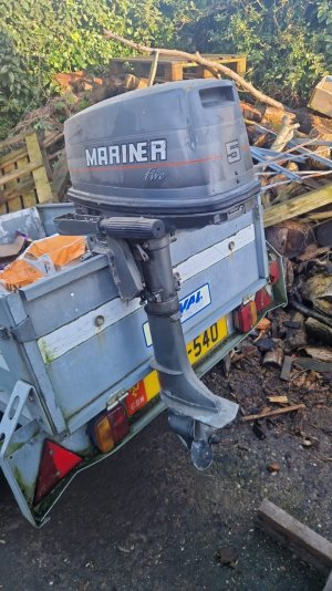

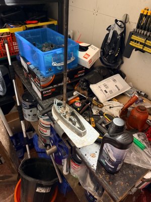

I nice little 2 stroke for my 3D 290 tender. Free of charge from a great mate so set to having a look. It pulled over but turned the prop. Oddly though, it would go in forward gear but the prop still span freely and wouldnt go in reverse! How very odd! Time to investigate!

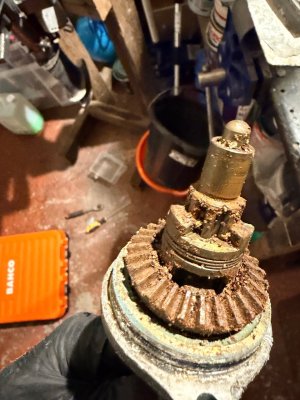

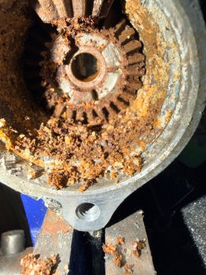

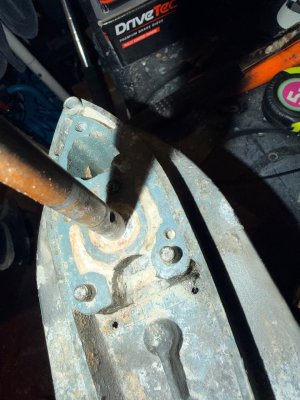

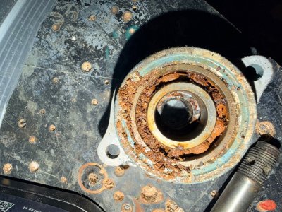

Pulled the lower and undid the oil drain. Nothing came out…not a drop…..oh dear. Deeper we go
Now im no engineer…..but im pretty sure thats not right! Oh well, it was free so next step was see if it’ll run. It did on the 3rd pull! Sounded good enough so decsion made. Im going to buy a bottom end. Interestingly, this is a yamaha with a mariner badge. Parts are super easy to find and given a whole replacement bottom edge is £135 delivered….its worth a punt. Ordered a whole new carb as well for £25!

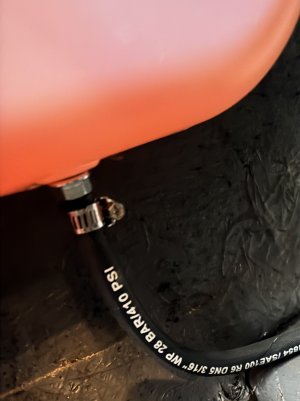

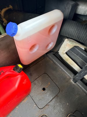

Just one mothership job this week which was diesel heater fuel supply. It was set up with a 25 litre outboard tank setup lose in the lazerette complete with fuel priming bulb! Not ideal at all. I like the separate fuel supply as the heaters are a bit fussy in fuel so stayed with it and replaced.

Does anyone know if a plastic diesel tank for a heater is ok for boat safety certification on inland water ???
Dont know why they wouldnt have put a standard on fuel lines. 5mm ID proper marked hose is like £5 a metre. That green stuff is rubbish. My soft line goes into hard line before the heater too which is good
You planning to fit one K?
Can't decide. The boat came with a separate stainless tank for the heater but its really badly installed. Filler hoses have a loop that traps water, breather hose too short and upside down breather so water gets in etc etc. Will probably take it out and see if I can re install it better. If not I have a plastic tank like yours. My prevarication is partly to do with the deck filler. Some idiot cut the hole in the deck too big, didn't seal it and water gets in around it. Unfortunately to get it out meant damaging it and I cannot find another deck filler that will work - screw centres too small. So I will need to repair the deck, cut a new hole etc. However if I take the tank out I still need to repair the deck.
Bit of a first world problem really.
My heaters both run from the starboard tank. No faffing around filling tiny tanks every five minutes. If your fuel quality isn't good enough to run a heater you have a problem that needs urgent sorting.

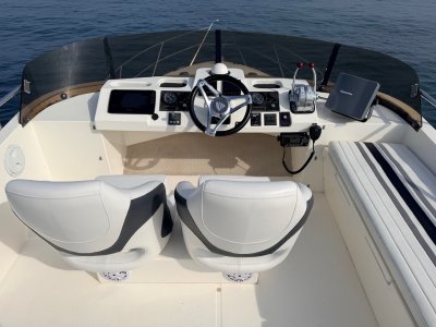

It was a lovely day and gives a glimpse that summer is returning! Boat ran perfect. Just needs a polish now! Happy with the flybridge dash now. Not overly keen on the radar on the gimble but i can live with it.

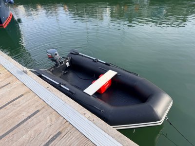

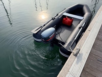

It was then time to tryout the freshly rebuilt Mariner! Its now a Yamaha as it is actually a Yamaha anyway!
Just a reminder….this outboard was free. £125 for the gearbox, £18 for the prop and £25 for a new carb. It runs like a top! Even planes with a 5hp! Only job lefton it is to change push button stop to a kill cord.

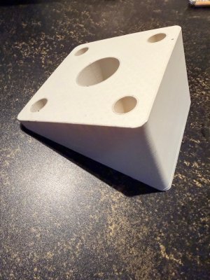

I’ll end with a quiz……..Ive had this 3D printed. Virtual pint for who can figure out why I need it!
