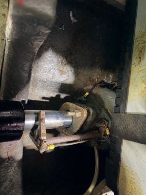

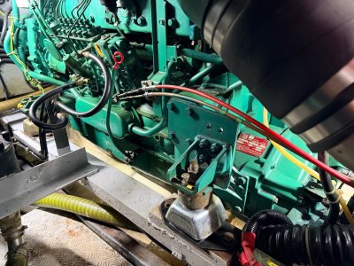

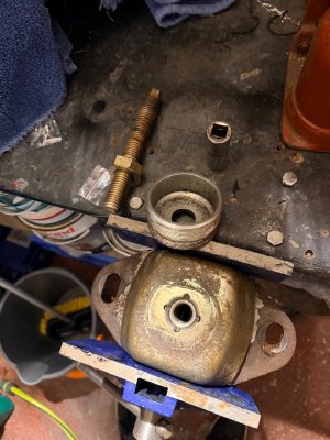

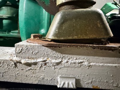

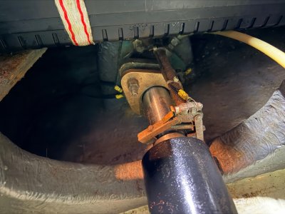

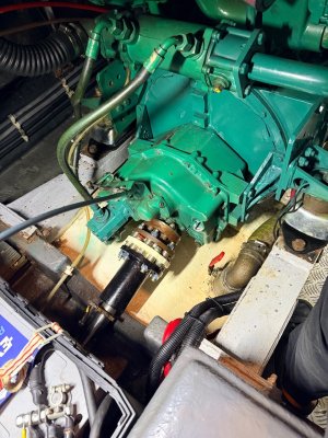

I wouldn't touch the P bracket nuts. If they are through bolts you could end up with a slight leak and all sorts of surprises. Try everything else first. Can you tell which side is causing the vibration?
Edit. On the engine mounts I would slacken the top nut off 5 to 6 turns, then lower the engine mounts until there is a gap, then take it back up again etc.
It could be one is actually under tension and an engine is effectively sitting on three points. Which stationary is OK, but not when it's all moving.
