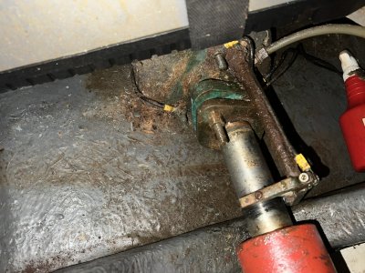

One question…..do the cutless bearings come with holes in them? The water feed for inboard end is the normal pipe of the engine seawater circuit. Is it a case of drilling a hole then lining it up when fitting with the injection pipe?
I may be wrong, but I thought the feed water pipe usually connected to the stern gland, either a standard stuffing gland type, or dripless type like "tide seals". The feed water would then flow through the rubber flutes of the cutless bearing to keep it cool.
I'm sure T.Norris Marine can give the correct advice. I'd be interested to know what you find out.
Thats what i cant picture. How does the water get in the flutes. Its a standard stuffing box so i must be missing something
Ive never seen inside the housing. Ill look friday and get some photos
That's my understanding too, certainly how they work on mine.
That looks the same as mine internally. Not taken it apart any further than re-packing it, but i'd expect that the cutless bearing stops sort of the water injection inlet, or it would only inject into the flute under the hole. As sharpeness said, check with Norris to be sure.
