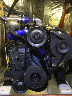

I used silicone hose on my 3 gm for the fresh water. Just bought some generic bends and a straight piece, plus a couple of metres of straight for the heat exchanger to the anti siphon and back to the exhaust manifold.
