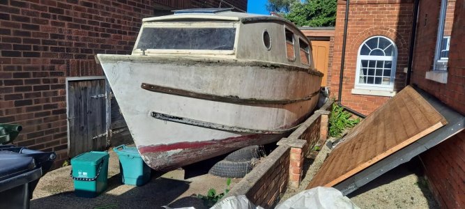

Continuing my search for a donor boat for an electric project and wondered if anybody had any ideas what make and model this cabin cruiser might be? Advertised as a 24ft.

Not at all sure! But as long as it floats I could use it as test bed for electric outboard conversion. I know I could use any old dinghy for that but if I could find something that might work longer term too that would be a bonus.
The reason I was hoping somebody might be able to identify it was if I could find pictures of a model in good nick to help evaluate if it might be worth the effort.

You only have to look along the hull and see she's had a hard life and having stood as she is - probably not cared for latterly.
If she was a 'Freebie - collect and take away' then maybe ... but I suspect she will be a heavy boat and need significant work to be suitable as a test platform.

That boat looks like you'd be doing them a favour taking it away but it will cost you a fortune and still have no value.
