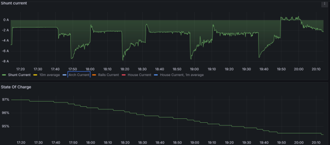

FWIW, this is mine (304Ah, now into its 3rd year):
two 20mm marine ply on the sides,
cut handles to help in carrying it - still lighter than a 200Ah 12V LA, and similar size...
8cells as it's 24V,
2mm thick rubber sheet between each cell (and cell to ply sides)
4X10mm rods,
two bottom ones closer to each other so that cells rest on them (rods have rubber hose over them so that they wont damage the cells)
busbars with black shrink on them to avoid nasty sorts,
(still not fitted rubber cups on the M6 nuts though)
perspex lid just in case, it's on a locker,
DIYBMS one pcb per cell to communicate state to BMS/passive balance to almost 1A, etc
on the locker above from left to right is power supply to the BMS, BMS (with lcd touch screen, - also wifi/bt), shunt and at the far right bluesea bistable relay,
Class T fuse not in this pic for some reason.
BMS linked to VenusOS raspberry pi which controls/communicates with BMS, MPPT controller (600W on hardtop) and Multiplus 3KVA inverter.
Main load is 1.8kW watermaker and usual crap onboard a 43ft mobo
Re tightening the assembly, I discharged batteries to circa 30% (iirc) and clamped it with a torque wrench at a reasonably low value (which I cannot recall, maybe @gregcope remembers - we discussed them in PMs back then)
Once a year I open the locker to see if they are still there :p
I do follow their performance via the Victron touch screen on board or remotely from victron VRM:
and or grafana dashboard:
boat currently on the hard, last three days charging is off due to having reached 99% SoC 4days ago and now on rest mode till SoC drops to 35% or so when it will start charging again. I've configured that, need to alter the top charging level but not had the time to deal with it yet. Ideally off season I'd like to have them cycle from 30-50% and just stay there with or without fridge running. I got a more or less permanent 1.3-1.5A @24V load from all the systems on board 24/7 (bms, n2k bus and devices, switch, 4G router, alarm, etc.)
