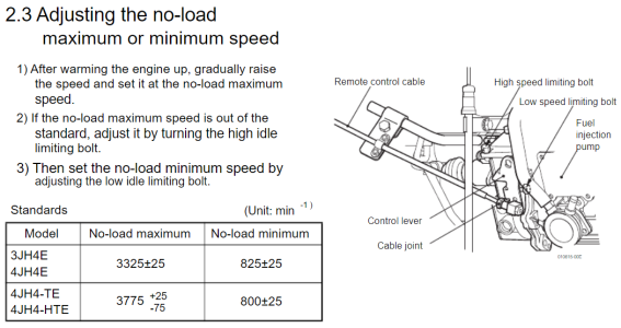

I am not sure what the specification is for the idle speed, but it's idling at around 800rpm and I have not noticed any change. I will check it next time out and see if it is different cold to hot. Do you know what the idle speed should be?

Check that the idle speed is being determined by the adjustable slow running screw stop on the engine anD NOT by the teleflex which is not precise.
The stop is adjacent to where the Teleflex connects to to the engine speed lever.
See this extract from the service manual

I've checked out the fast and slow stops, the idle speed was low at about 730rpm. Adjusted to 825rpm and engaged forward and reverse gears multiple times without problem. Hopefully that has sorted the problem, time will tell.
