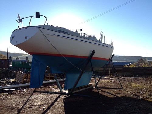

Last year I sourced a cradle for my Rival 41C, 41' LOA and 10t. The lowest cost new cradle I could find in the UK was from Tenamast who quoted £1400 including delivery to Largs from Ayrshire. This was a 6 legged, fixed based, undercoated cradle i.e. it could not be broken down for transportation by car, trailer. A 6 legged, sectional cradle from Tenamast, which can be transported in the back of a Volvo Estate, or trailer, costs £1995 incl vat. Again this was the lowest cost I could find.
Now, Tenna actually quote for an 8 leg cradle and I queried why all the other companies quote 6 leg. This is the reply: -
We have been made aware of other companies offering smaller cradles in the past to try and be more competitive with their prices. This started when the new edition of the Yacht Harbour Association layup guidelines changed a few years ago, they used to specify a 6 support cradle for yachts up to 40ft and 8 support up to 50ft, this is now not part of the guidelines but many marinas and insurance companies still work to this guide. This is the reason we have stuck with this guide.
This doesn’t mean that our cradle is any weaker than any other companies cradle, our 6 support is as strong if not stronger than the cradles that other companies offer.
So if you are in the market for a new cradle, you may find that Tenamast in Ayrshire provides the lowest cost amongst all the UK cradle suppliers at least for a 41' LOA, 10 Tonne, yacht. In the end I bought a second hand cradle on eBay for just over half the cost of a new Tenamast.
I paid £795 for the 4 Leg Cradle below designed for up to 18 t and about 14' maximum beam. As you can see this location is a bit exposed, my tub has sat through all the big gales so far with no hassle. The previous owner had a shorter keel than mine and he used shores under the bow and stern, 2 each side, for additional security. Most of this fits inside an 8' x 4' trailer except the base which is 10' long. So its not back of the Volvo transport, but easily transportable all the same.
I hope this gives you and idea and confidence on size. It should also be noted that Vyv_Cox of this forum has wintered a 32' yacht on beach legs, on a marina hard. If the yacht can sit on her keel, then you do not need much to keep her from falling over.
