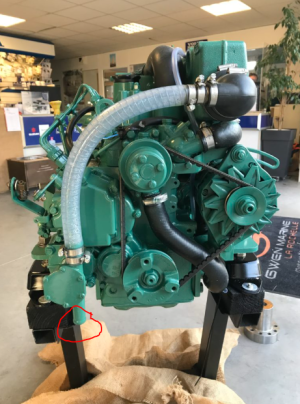

I read the manual but I'm not fully sure what to do exactly. Google and forum search is also not very clear. Some say to disconnected the hose near the saildrive connection (throughhole) and connect a longer hose to it and then in a bucket (so its in the water).
Then turn on the engine and let it run a bit so the "sweet water" gets run through the system.
Seems quite difficult to do this when alone, is there a better or other way? Any suggestions?

The pipe marked in red is your raw water (sea water) inlet on the engine and is more accessible than the other end which is on the saildrive ... you can attach a pipe here and submerge the other end in a big bucket of fresh water.
BEFORE REMOVING THIS HOSE MAKE SURE YOU SHUT THE VALVE ON THE THROUGH HULL (Saildrive) IF THE BOAT IS IN THE WATER.
Then run the engine until it has sucked the contents of the bucket out (and flushed it through the exhaust) and you will have removed (or at least diluted) the salt water in the heat exchanger and exhaust.
PS: Also a good idea to do this as the last thing before lift out or on land, obviously if you run the engine in the sea aftwerwards then the system gets filled with salt water again.
