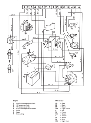

The wiring schematic in the owners manual shows the oil pressure gauge sensor and the low oil pressure warning light/ audible alarm sensor ( #3 and #2 respectively in the snip from the manual )
(#1 and #4 are the sensors for the high temperature warning light and the temperature gauge)

The wiring diagram is in the owners manual which can be downloaded from VP's website but it was not straightforward to find
Go to Manuals & Handbooks | Volvo Penta UK & Ireland
Scroll down and enter MD31 in the product Designation box. Select MD31A (INB) and click on search.
Select the Operators Manual that covers AQAD31A, Agree to the terms
Note the file name (7749437.pdf) its been saved as ( you can change that ) and the location of the file.
