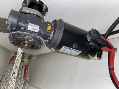

Can anyone please explain what the grey filings are that have collected on my Lewmar V3 windlass gear box? They are soft and crumble when touched.
Am I correct to assume that the right thing to do is to dismantle and clean / inspect the unit?IMG_4738.jpeg

That is a sealed unit so highly unlikely that the material is from the motor.
Is that rotating part making contact with the rope?
Y

Looks like corrosion product to me. A thin coat of paint is poor protection from seawater. My windlass motor is wrapped in Denso tape, excellent protection but horrible to handle. I wrap it in polythene. Waxoyl is easy to apply, dries hard and offers good protection.

The biggest problem with most windlasses is that salt water brought in from retrieving the chain or waves over the forepeak can drip, or even pour over the windlass’s gear box / motor. This is usually easily fixed with the addition of a pipe or baffles.
I think this would significantly reduce the corrosion pictured.

The bit you need to release is the silver stainless steel part with "Fast Fit" written on it. Somewhere around the back is a knurled nut you can undo, then it releases like a big clamp.
At that point the entire gearbox and motor combination will be able to drop down off the windlass shaft (though the wiring may require disconnecting).
The gearbox is "sealed for life" and absolutely no need to strip anything apart. This is extremely "light" corrosion compared to many I've seen, but if you want to protect it with additional coatings, now is indeed the time of course.

Are the crystals just salt from sea water? A quick wipe with a damp rag may guide what to do next.

Looking at the OPs original picture the windlass looks new and almost unused, unused except for the corrosion. I also note another member suggesting the level of corrosion is not as bad as he has seen on other, 'similar', windlass.
I am amazed that the windlass has suffered so much corrosion - its meant to be designed to be located in a wet anchor/chain/windlass locker and that seems very far from this ideal in the evidence seen with this example. A lot of the corrosion appears to be centred at the junction of a base plate/flange and the aluminium casting and as the gearbox is meant to be sealed for 'life' the seal looks a b it questionable.
I'd definitely be trying to paint the whole assembly with Vyv's coating - Noelex baffle will improve the situation - but the locker is always going to be saline and damp.
I'd be having another look at the windlass and having a word with Lewmar, or whoever might be relevant, on warranty before I do any painting (unless the windlass is already a few years old).
I think Baddox should get the gold star.
Wipe and look at the spot. For white corrosion, it would have to be an aluminum casing and there would have to be an obvious paint failure. No paint failure, it is not corrosion. Obvious.
Even if it is aluminum corrosion, it is cosmetic. Additionally, the unit is sealed, and what you see on the outside has NOTHING to do with the inside, sort of like having rust on the outside of an engine. The corrosion is not around the seals or joints. If you open the case you will disturb the seals and probably make things worse. Looks newish. I'd leave it alone. I seriously doubt opening it will accomplish anything positive.
