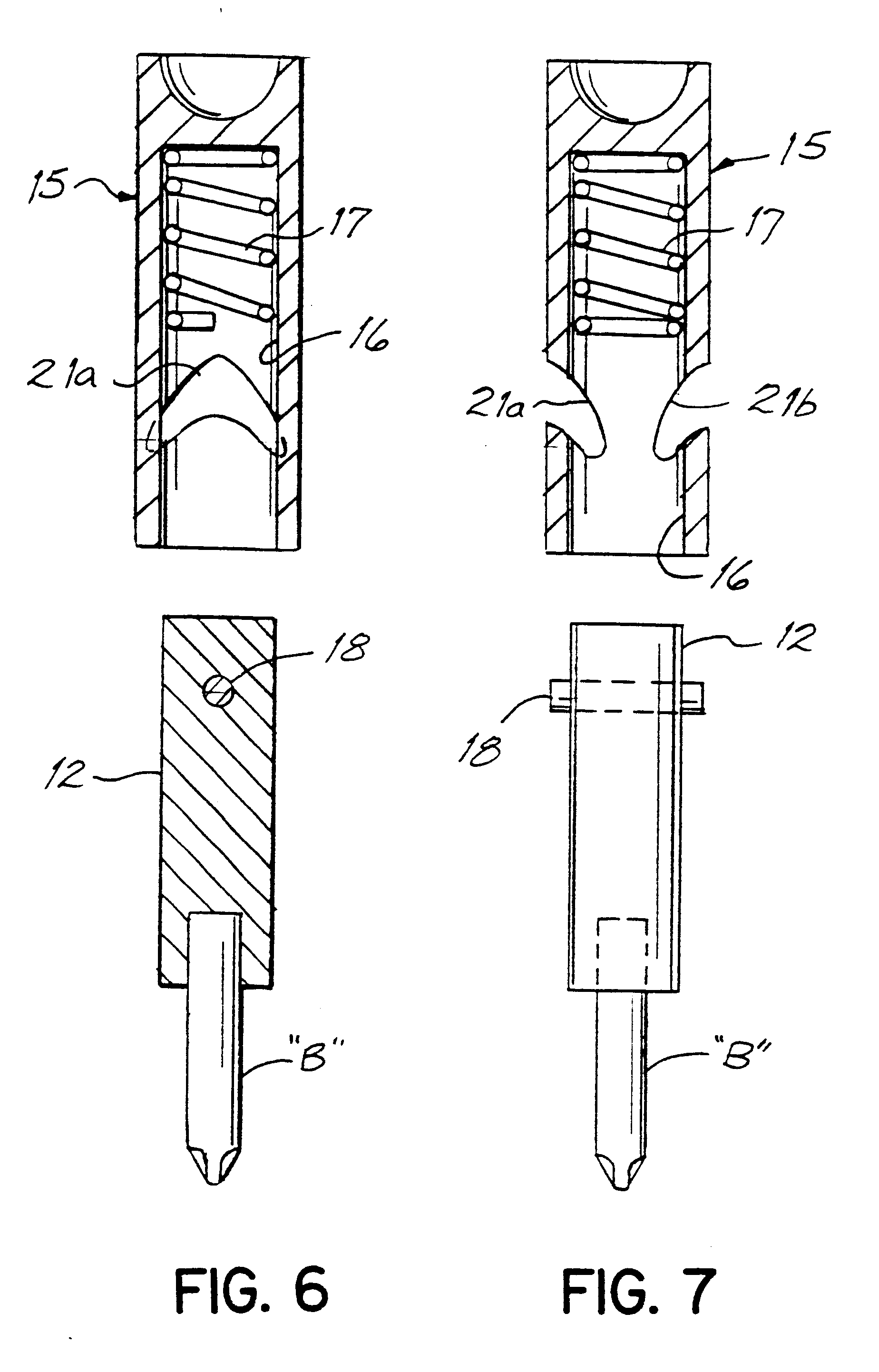

I've no idea how much of an impact wrench's torque, comes from the motor's actual turning power, and how much comes from its rotation simultaneously hammering down on the nut, such that it is momentarily, fractionally looser on the thread and easier to turn?
The electric ones use the motor to spin up a flywheel. When it's going fast enough, a centrifugal sprag clutch engages and it gives a wallop. The motor's output is irrelevant at that point, are determines only the time between wallops, which can be seconds, compared to the constant rattle of blows from an air-powered one.
I can't see why a slightly less highly-specified impact wrench couldn't effectively turn a winch. 300Nm, perhaps?
Because they might give you 300Nm for 10ms every second or so, if you're lucky.
I don't know how different the action of an impact driver is - but I've assumed that again, there is a 'ramp' inside the chuck so for every turn the screw-bit makes, it is also thrust forward or downward
Yes, more or less. A pair of ramps inside the outer casing and a pair of projecting lugs from the inner part which get driven round the ramps, against a spring, when the end is hit. The turning force comes from the wedge effect while the main effect of the axial force is to prevent the bit from jumping out. Does this help?
But do the high torque ratings of these machines express what their motors produce ...
No.
