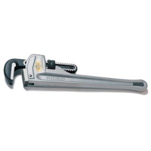

If you don’t have some, buy stilsons which are enormous pipe wrenches. This is vastly preferable to the grinder method which I found ineffective, time consuming, dirty, and got the fitting hot enough to boil the old sealant.
Stilson will remove the old valve easily and the nut and will be useful to push the old skin fitting around to break the old sealant. Standing on the old skin fitting usually pushes them out.

Yes good point. I bought two sizes when working on my through hulls. I was saying Stilson since in the UK it’s easier to find info with that term
Interestingly, even though Stilson was an American, the style is now simply called a pipe wrench, with Rigid being the premier manufacture. Other pipe wrench styles (chain and strap wrenches, for example, are identified by type. Aluminum handle wrenches have taken over the pro market, because they are SO MUCH easier to use all day.

I only ever knew Stilsons as Stilsons, not as pipe wrenches. Many devices can be used as and called pipe wrenches but they are not Stilsons. Mine are made in China and I have a small one maybe 300mm long and an even smaller one 150mm (length can be increased with a suitable piece of steel pipe). I know of really big ones - but never had the need to use one. I find them a bit coarse for hull fittings and prefer a Plumbers wrench, this sort of thing https://www.aliexpress.com/item/100...ab7cd244bebba4bcad0e0bac463&afSmartRedirect=y.

That plumbers wrench is useless for removal of the large nuts on through hulls but a useful tool for holding the hoses still.
