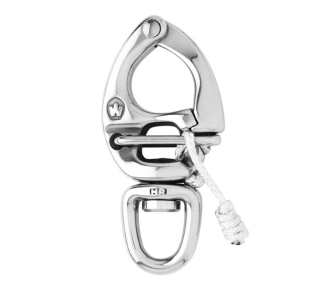

I am wondering if anyone has any arguments against using Wichard’s Quick Release shackles like these
on spinnaker halyards.
Wichard say they’re suitable for this application but every boat I sailed on had either Tylaska-type shackles or the more conventional ones on halyards. I’ve come across these only on spinnaker sheets.

I would have though the chances of the small release 'toggle' or puller catching on something either during the hoist, when hoisted or when it should be coming down is not something that can be entirely ruled out.
There are others with MUCH more experience of hoisting coloured stuff but I wouldn't. Not sure what the advantage would be over a soft shackle.
The advantage of these is that you can attach them quickly with a single hand whilst using your other hand to hold onto something. No advantage over the Tylaska-type ones apart from I happen to have these.
The other advantage is Tylaskas require selling a kidney or two.
I go standard snap shackle for the halyards and those wichards for the sheets.
The disadvantage is that they tend to decide to release just when you don't want them to either under shock load or by catching on thing's.

Dad's old boat had these on the kite halyards. Occasionally the bit of string snagged something and just opened the shackle just as the sail hit full hoist. Which was suboptimal. We improved things by trimming the string down as much as possible....
The Tylaska type are better.
Thank you - that's the kind of experience I was after. Of course Tylaska is the bees knees but happen to have the Wichards spare. I am convinced that they are risky for halyards, and I might use one of them for the tackline of the asymmetric instead.
