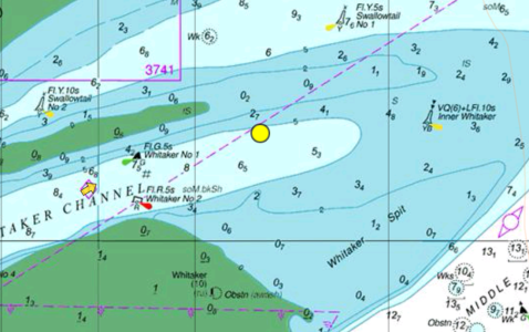

Wondered if anyone can assist- I’m doing some passage planning for a trip to Burnham on Crouch from the Swale.
I’m confused about the location of the Whitaker number one and number two bouys.
My records show they were moved in 2021 which seems to be confirmed by
The info on Crouch Harbour Uk:
“June 16 2021
  • Whitaker No 1 LT Buoy has been moved to a new position of 51°40.530N 001°05.400E
    Shape, colour, top mark and light FL. G. 5. remain unchanged.
  • Whitaker No 2 LT Buoy has been moved to a new position of 51°40.250N 001°05.400E
    Shape, colour, top mark and light Fl. R. 5”
But my 2024 Reeds Almanac gives the old, previous positions eg in the case of Whitaker No1: 51.40.69N 01.06.67E.
Have they been moved back to their previous position ?

Looking at a current chart the updated positions appear to be correct. The old position is about 0.8nm further to the east. Here’s the position plotted:

Thanks - I thought that was most likely. I am however surprised Reeds got it wrong, as they say they update all data according to the Notices to Mariners issued.But it’s 3 years out of date. It’s annoying as I consult Reeds to update my waypoints before a passage. Not sure I will do that now.

Umm. It is a bit of a big miss by Reeds. Crouch Harbour Authority issued a local notice in June, 2021 which Reeds probably wouldn't see (checking every local authority round the whole country every week could quickly drive Reeds mad). But the UKHO issued three notices in 2022: a preliminary notice in week 28 of 2022 advising a general warning that the buoyage had been changed (NtM 2783(P)/22), a permanent notice in week 30 of 2022 advising the positions of the three pairs in the Whitaker Channel (NtM 3003/22) and another permanent notice in week 32 of 2022 announcing a new block for chart 1975 (Thames Estuary - Northern Part) showing the Whitaker and Swallowtail channel changes (NtM 3188/22).
In fairness, logistics for chart changes worldwide are a challenge. I suspect the 'miss' occurred because of the mechanics. Reed probably would rely on chart 1975 for changes - that is the primary chart. NtM 3003 specified changes for chart 3750 only which is a local chart of the Crouch and NtM 3188 specified the block for chart 1975. So whilst the positions of the buoys were specified for chart 3750, chart 1975 had a block (i.e. an image) not the lat/long.
Note Reeds still talk of 4 pairs of buoys in the Whitaker (No 1 & 2, 3 & 4, 5 & 6 and 7 and 8). The 2021 changes was removing one pair so there are only 3 pairs. Note also that Crouch Harbour Authority tend to lift individual buoys ashore temporarily for maintenance this time of year. The CHA is very diligent as to the issue of local notices including short term changes.
