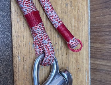

This is how I do mine. I leave a longer tail on the whipping and then use that to sew 2-3 loops on the end of the rope. I then do half hitches to keep the whole thing together and add a bit of strength. It might make more sense to do this first and whip over the top, but I've not had one fail yet.

I used to do this, but it's not reusable hence changing to the method I showed above. Now I just tie a bowline in the mousing line through the little loop any time I need to. If you're sewing anyway then sewing a loop is just as quick and you only have to do it once.
