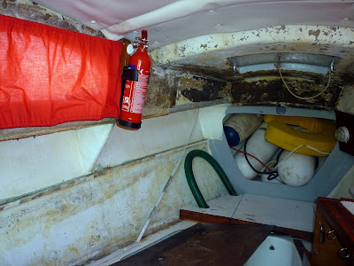

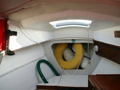

I've done inside my lockers with white garage floor paint, Cant remember the brand. Only done it this winter but it sure freshens it all up. I'd go over it all with bleach first to kill any mildew spores that are left.
Fantasie 19
23 Mar 2009
4,503
Chichester, West Sussex
Have you tried acrylic water based paint? It produces a surprisingly good result, dries quickly with little ponk and brushes/roller can be cleaned with water. Works for hot steamy bathrooms..
Plus one - I've used standard Homebase/B&Q Kitchen or Bathroom paint on both my boats... its formulated for a damp atmosphere and can come with built in antifungicide..
