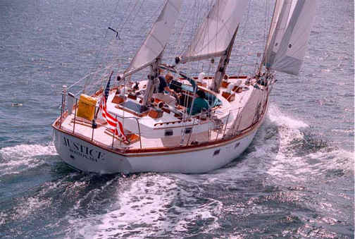

If my yacht was steel (or aluminum) I'd go for a hard dodger. But my yacht hull and deck is cored which would make mounting a hard dodger a nightmare. I will have to study how soft dodgers are framed to see they would be easy to mount on my yacht.
I associate solar arches, life raft mounted on deck, dinghy davits and hard spray hood (dodgers) with coastal cruisers which never venture more than 100km from a safe haven.
attachment.php
I want my yacht to meet the criteria of a "Blue Water Yacht" (This is a steel version of the yacht I am building)
