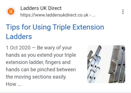

Are you trying to say that trapping fingers is limited to "those telescopic jobs"..
Try telling that to the people that have carelessly damaged hands in simple extension ladders (or even in folding steps).
Compliant telescopic ladders must have soft close to reduce that risk. Extending ladders don't seem to have a soft close feature!
