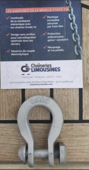

i have a grade 70 anchor shackle from Jimmy Green which didn’t fit my boat, I have a through-stem roller which is quite narrow, so I had to find a different solution. It’s been in the water once, since then in my shackle bag. It was £60 odd, I could send you the invoice for validation. See pictures attached. It is a high spec shackle for 8mm grade 70 chain.

The st/st Peterson shackle pin is secured with high-strength red loctite. That will take heat and brute force to remove.
The galvanised Force 7 shackle comes prepped with blue loctite so can be removed if/when I replace chain or anchor.
Both shackles exceed the breaking load of the chain.
Compared to my previous arrangement of two oversize, rusty shackles of unknown provenance, these glide over the bow roller easily enough.
