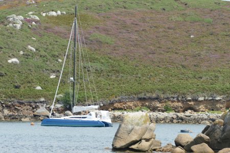

To my eye, the Dragonfly 32's look pretty handsome (albeit rather better without the cockpit tent):
Met this one, Firefly, in Scilly, in 2021. I was most envious of her ability to anchor shallow, whilst still go to windward effectively. More envious still, when she blasted back to the shelter of the mainland (clocking 10-15kts SOG on AIS) the afternoon before Storm Evert hit. Whilst we slower boats stood by to get clobbered, and duly were.

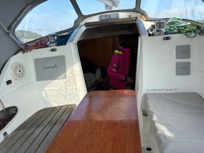

Cramped….
Mrs C is putting the kettle on. Perhaps it also shows how far from the tiller the sheet winches are. There are 2 winches on the cockpit coamings, I reckon they might be worth a shot if short handed. 2 being fully crewed for cruising, 3 for racing. Taken from just aft of the traveller, theres acres of room there for a large gentleman or lady to sit, plus a hinge down helmsmans perch, which looks over and past the sprayhood. Perfect view of the jib telltales too. On a DF, you need to be observing them upwind, or you’ll thunder off onto a reach and not make the upwind progress you have heard about. We are relaxing in the ungainly cockpit tent. We can’t see it, why should we care🤣 that’s wind, and pertinent data repeat to Stbd, 12” plotter to port. We have a Yeoman, and paper charts, but most stuff happens on the fly. If ypu spent too long down below faffing about, you’d already have arrived.

Useful pic. Hadn’t understood that the jib winches were on the coachroof. Suppose they have to be, to get the narrow sheeting angle…..

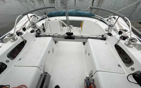

BUT, what do you reckon the second set of coaming winches (which I’d mistaken for the jib sheet winches) are for, half way down the cockpit, in this pic of the solent based DF32 currently on brokerage?

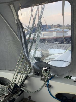

They are for the folding mechanism, the barber haulers, and the kite if you're sailing with the sprayhood up. Obviously, if there’s serious pressure you’d want the bigger ones on the coachroof, so it’s goodbye sprayhood. You’d probably be racing if you’re in that much of a hurry though. That mainsheet will have to be mostly winched. This is ours.
2 speed, low gear is 24:1. We have to winch that at about 15kn. You just can’t close the leech otherwise. It needs to be nearly straight, and on the centreline. Absolutely no windward traveller, that just kills you.

Also in that photo, slightly faded white/green is the barber hauler, pulls the jib sheet out to the ama for reaching, and blue is the asymmetric spinnaker sheet. Halyard as you’d expect on the coachroof, tack outhaul in in the stbd hand locker.
Out outboard remote unit is at the back of the cockpit, mounted sideways. The 28 has that in a cockpit locker, fore and aft. That is a really good innovation. It’s on the lid at hand height when you open it.
