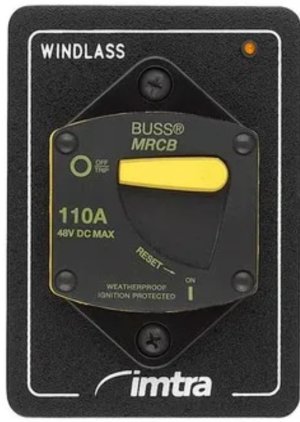

The anchor was stuck fast and I think I've melted the fuse for the anchor winch but I can't find it. The boat is a 2009 Merry Fisher 805. Any suggestions gratefully received.

The MF 805 is like the Antares 760 and I have that style of breaker.
Might be anywhere on the boat though.
On mine its down in the locker under the steering console (the one with the calorifier and the shore power control box).
