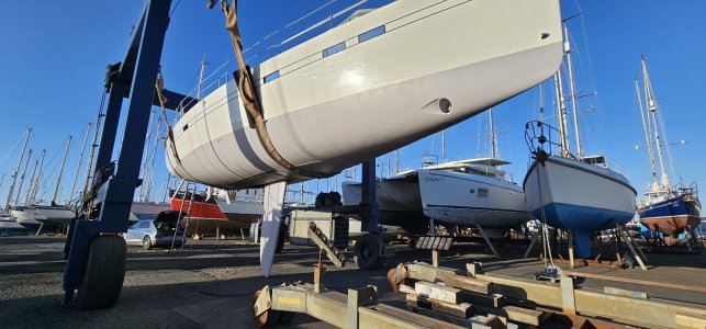

Eynhallow in the slings after finishing the antifouling.
