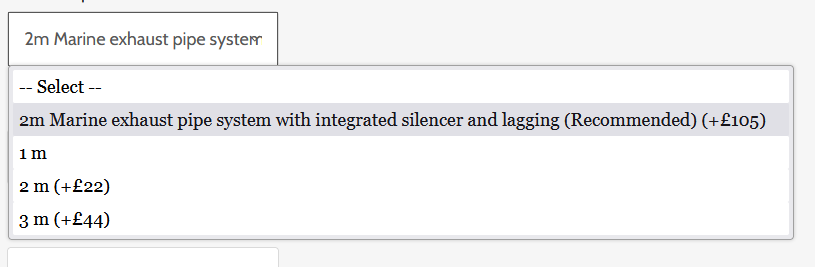

i dont know whether to go for the 2kw or 4kw still, will just heat the main cabin for now and maybe upgrade to another duct for the v birth a later date. trying to save money too.
Also looking at getting a separate fuel tank as dont want to tap into the boats tank.
do i need this also-
is this cheaper elswhere?
