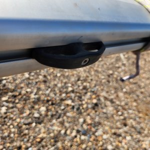

What is this called.
It's a Selden reef slider for the boom. It's been discontinued. See here
Selden T-25 Reef Slider - VR Super Store
As I understand it it's supposed to stop the reefing lines on a slab reefing set up from sliding along the boom, but since this doesn't generally happen, most people don't bother with them. At least that's what my local Selden agent told me. I've never used mine.
It's a "bash your head on something else superfluous on the boom" device.
I have something similar in stainless, it does what it says on the tin. 🤬
I think they might have been more useful when mainsails were slotted into a track along the foot, as more difficult to take reefing lines round the boom.
Now that most sails are loose footed, taking the reef lines round the boom is simpler and stronger, hence these become largely redundant.
