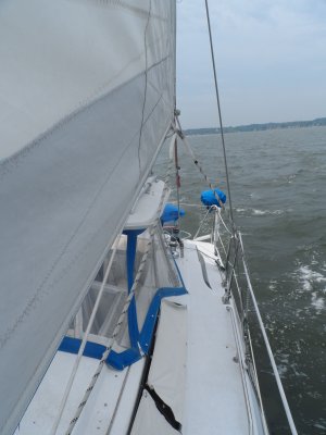

Yup, kind of a pain but workable. In this case the multihull cap shrouds prevent hauling a ~ 125% genoa close enough for windward work. An outside track makes it into a reaching powerhouse.
That is what worked for my PDQ, since the angles were wrong for 3D leads. There is also a down haul available for the outside track (same as spinnaker twing) when reaching deep but it rigs with a small snatch block and is not rigged at this time (looks like post 8, but only for the outside sheet). Soft shackles make it easy to remove the unused sheet if desired.
Different solutions for every boat.
